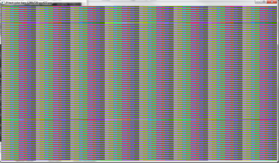

I am using an ADV7481 that connects via MIPI to an i.MX6Q (running Linux) over 4 CSI lanes. I am attempting to set up the ADV7481 for HDMI input, YUV 422 8-bit, 4-Lane CSI output. I originally posted this question in the Analog Devices video and Linux forums, but I am still stuck even with their help.
I am using the “:08-08 Free-run MIPI TxA CSI 4-Lane - YUV422 8-Bit, 1280x720p 60Hz:” snippet from the ADV7481ES3C-VER.3.6c.txt file for the ADV7481 required settings in order to generate a test pattern (colorbars) over the MIPI connection to the i.MX6.
I am using the driver developed by Wally Yeh, and discussed here. The driver has been working so far, and I have extended it with the script I just mentioned above. Wally had been using it for 2-Lane capture, but I was able to set it up for 4 lanes, and I have confirmed that in the lab.
I can communicate with the part successfully, and can program the EDID successfully (verified with a  GoPro camera hooked up to it), so I know communication is good between the i.MX6 and ADV7481.
However, when I capture the test pattern, it has obvious defects. I’m not sure what it could be, but I am also unsure what the color pattern is actually supposed to look like at this resolution. I have attached a screen grab of the test pattern I am getting. It looks like the color bar pattern is being repeated 8 times, and I don't think that's right.
Looking at the binary data for this raw video capture, the format actually looks like yuv420, not  yuv422, which is very strange. The settings are clearly yuv422 going to the ADV7481, so this is the most important issue to resolve at first. Why am I receiving what appears to be yuv420 back? I am using ffplay (from the ffmpeg project) in order to play the raw video capture, and it claims that the color format is also yuv420 when it attempts to discover the format automatically. This software has been used to view other video captures in yuv422 format, so I trust it is not being faked about the format.
Command line to run raw video file:
ffplay.exe -f rawvideo -pixel_format yuv420p -video_size 1280x720 test-color-bars-1280x720-yuv422.yuv
Another developer analyzed the binary data when I ran the same script (except set for solid blue screen instead of color bars), and he also concluded that the format was actually yuv420 instead of yuv422:
Looks like YUV 4:2:0  (https://en.wikipedia.org/wiki/Chroma_subsampling)
I see 0x0f for the first 0xe1000 bytes(0xe1000 == 921600 == 1280*720)
0xC4 for the next 0x38400 bytes(0x38400 ==  230400 == (1280 * 720 / 4))
0x75 for the next 0x38400 bytes
I have attached both the color bar raw video file, and the solid blue raw video file in separate zipped attachments.
Here is a link to the post I made in the Analog Devices Video forum, and here is the one I made in the Analog Devices Linux forum.
In summary, I’d like to know what could possibly cause the repeating color bar pattern in the i.MX6, given the setting from that script, and why the received format appears to be YUV 420 instead of YUV 422 like the script is attempting to set up in the ADV7841.
My hunch is that the ADV7481 is set up correctly, but I'm missing something in the processing chain in the i.MX6. Hope that makes sense.
Here is what I have from a 1920x1080p test run, and this has 3 repeating test patterns. The settings I am putting in the ADV7481 are the same except for the video resolution.

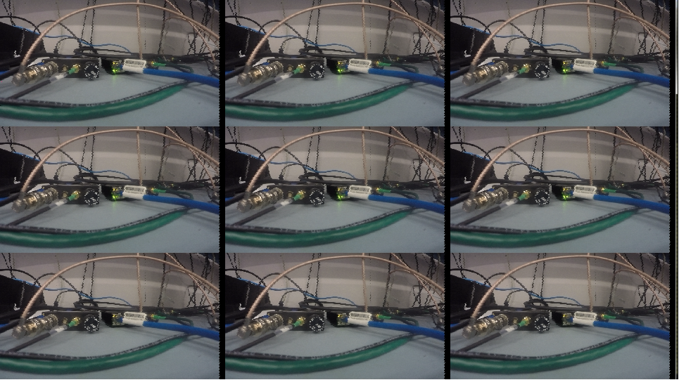

I was able to get to the bottom of the pixel format issue, and it was between the i.MX gstreamer plugin and the MXC capture driver in the V4L2 stack. When the gstreamer plugin would use the VIDIOC_G_FMT ioctl to get the pixel format, the MXC capture driver would not report back the format from my camera driver, but instead would report back the YUV420 format from it's own internal default settings. There was no way for me to override that.
So, I modified the MXC capture driver so that it would first query the camera sensor pixel format, and if it was different, return the camera pixel format. Otherwise it would return the default as it had in the past (even though I think that is a bug anyway).

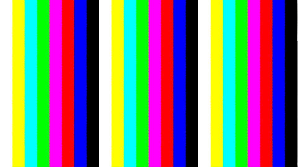

But I am still getting the same issue with my color bar test pattern. For 720p, even though my camera is set to send 1280x720 width and height, my gstreamer output is 800x720. So when it is viewed as 1280x720 (like it is supposed to be) it looks like this:
But when viewed at 800x720, it looks right:
Even more strange, is when looking at a 1080p camera capture, you can see that it isn't 3 repeating patterns (like I showed at the end of my original post), but 9!:
(repost the 1080p colorbars):
That's 9 images in one frame. If you look at the 1080p colorbars, you can see now that the smaller frames are stacked on top of one another to make it look seamless, but it really is 9 images.

Thanks Igor. I did find an issue with reporting and setting the right pixel format in gstreamer-imx, and I'll let them know if it hasn't been fixed already.
But the issue I am having with the video is only happening at 720p and higher resolutions, not all the time. At 480p and 800x600, everything works great. No problems with the resolution, test pattern looks good. It's only at 720p and up that things go wrong. I have scrubbed through imxv4l2videosrc and found some issues, but nothing that explains that problem.
I have been looking at the frames just after they get transferred from the IDMAC, and they are already wrong when they hit main memory. I've been printing out the first handful of bytes in each frame right after the DMA xfer, because those should always be the same given a test pattern. But that is showing that the image is already corrupted, and that's before gstreamer has a chance to put them through the gstreamer pipeline, so I don't really think it's a post-IPU issue. I think it's happening somewhere between the MIPI input and the output of the IDMAC.

willhoie
Hi Igor. I have confirmed that the MIPI interface is working correctly. I have used a MIPI tester to send good MIPI packets, and bad ones with a bad CRC. The MIPI peripheral correctly determines good and bad packets. The issue is between the MIPI CSI-2 peripheral and the IDMAC.
I have run experiments by changing the MIPI frequency, and I have found that I can get 720p video to work correctly at transfer speeds under 400Mbps over 2 lanes. At four lanes, the frequency must be cut in half (200Mbps) in order to receive 720p video without distortion.
Again, this is looking at frames just after the DMA xfer completes and before the gstreamer pipeline, so gstreamer is eliminated as the problem. The distortion is occurring somewhere in the processing sequence of the IPU.
Again, the distortion I am experiencing is that at 720p, the video frames are downsized from 1280x720 to 800x720. At 1080p, the video frames are downsized to 640x360 and tiled 3x3 into a single 1920x1080 frame. Lower resolutions work fine.
I have looked at the downsizer block, and I wondered if perhaps the DMA was misfiring into the downsizer at the higher data speeds. But I changed all the downsizing and resizing coefficients in IPUx_IC_PRP_ENC_RSC, IPUx_IC_PRP_VF_RSC, and IPUx_IC_PP_RSC but it had no effect. However, the output looks like it is going through a downsizer somehow, but only at MIPI speeds above a certain threshold that depends on the number of data lanes (2 or 4).
4,103件の閲覧回数

willhoie
Thanks Igor. I have also tried the OV5640 camera MIPI driver with the MIPI tester, and it also exhibits the same distortion of video above 400 Mbps.
I don’t think it’s a problem with my camera driver, or the OV5649 driver either. There is something going wrong between the MIPI CSI-2 receiver, in which the MIPI packets are received successfully based on the CRC check, and the IPU DMA channel.
I posted the IPU register dump up thread already, but I don’t see anything wrong with it. Nothing that would explain downsizing above 400 Mbps.
