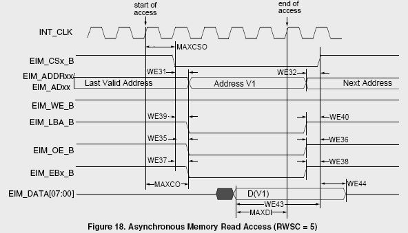

We have some question about i.MX6Q EIM timing when it is in asynchronous read access.
We heard the latch timing of async read access is on the falling edge of a half clock before end of access in past.

  Data are latched at the recent rising edge (of internal clock) before
OE or CS going HIGH (inactive) ; whoever comes first.
Please refer to end of access point below.

I confirmed OE and CS negate timing is a rising edge of internal clock.
I think in the case of Figure 18, the trigger for OE and CE negation is the rising edge called "end of access".
Then, data latch timing is one more previous rising edge of "end of access"? or latched on the "end of access"?

latched on the "end of access".
