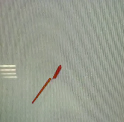

MACHINE_NAME=imx6qsabresd
DISTRO_NAME=fsl-imx-xwayland
IMAGE_NAME=fsl-image-qt5
Has try export FB_MULTI_BUFFER=2,3,4 & 8, but tearing issue still happend.
QtQuick/build-QtQuick-imx6-Release/QtQuick -platform wayland-egl -plugin evdevtouch:/dev/input/event1

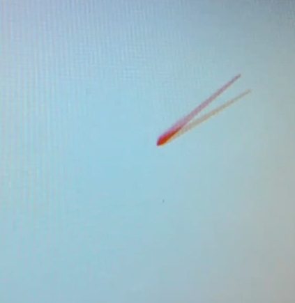

I built your application and saw this effect. This is not tearing issue.  When tearing, you saw broken needle. this something related with human eyes visual effect.  You are rotate whole circle in one second, I tried to change the rotation in 3 or 4 second in main.qml, the double pen is gone.  or If you hit Ctrl_C at any time, the snapshot only show one needle, never 2.  So, I think it is ok.  I check the code to make sure vsync is called. Please follow in any case I miss something to reproduce it.

Can you check your weston script in /etc/init.d/weston?  You need to export FB_MULTI_BUFFER=2 or 3, in this script before weston started. if not, set it and then reboot.   If you set FB_MULTI_BUFFER after this script is run, weston cannot be aware of multi buffer set up.

jiahongyang
Hi Bio_TICFSL,
Thanks and it works.
Before set "export FB_MULTI_BUFFER=2"  on "/etc/init.d/weston" the tearing issue happened as the picture 1.
Picture 1: The Tearing Needle
After set "export FB_MULTI_BUFFER=2"  on "/etc/init.d/weston" the tearing issue is fixed as the picture 2,
but is there any suggestion for reducing needles shown on one frame ?
Picture 2: Multi Needles Shown on One Frame
