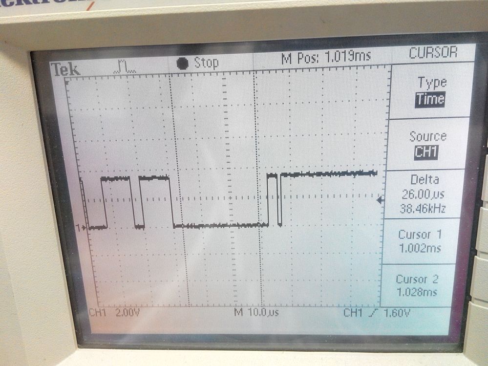

Yuri
  as for short start bit - from the i.MX6 D/Q RM :
"The start bit is validated when 0s are received for 7 consecutive 1/16 of bit times following the 1-to-0 transition."
  Being completely accurate, we cannot guarantee proper UART operations, when UART specs are violated.
The short start bit period must not be less, than 7/16 of bit time slot.
Yuri.

maxim1
I have the same problem!
linux 4.9.14
DMA is disabled.
UART speed 307200, 8n2.
The imx6 receive 10 zero bits and fixes the FRAME error.
Next, the imx6 receive a short start bit (1.2 usec) and goes nuts.
The processor starts to accept infinitely 0xFF.
Helps only software reset uart.
URXD0 = 80B9
URXD0 = D000 - FRAME error
URXD0 = 80FF
URXD0 = 80FF
URXD0 = 80FF
URXD0 = 80FF
Photo of oscillograph.
If the processor receives the normal start bit (3.2 usec), then there is no problem.
URXD0 = 8007
URXD0 = 80FF
