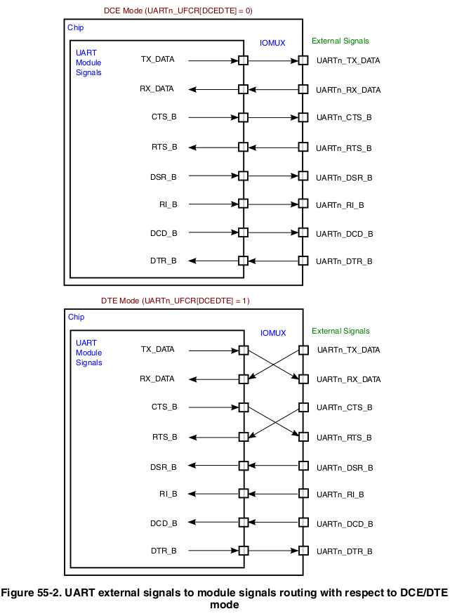

In addition I'm attaching the excerpt from NXP documentation

    Yes, we are often confused about these 2 concepts on UART port. Let me give you my explanation to you :
DCE side: provide clock to other side(DTE). In the mode, CTS is OUTPUT, RTS is INPUT.
DTE side:  working with clock from DCT.      In the mode, CTS is INPUT, RTS is OUTPUT.
Gernerally speaking, before you connect one device to the other, you only need to confirm CTS & RTS directions of UART for 2 devices. For example, connecting UART of I.MX6 to that of PC.
PC( usually, DTE device): PC_UART_CTS ----INPUT; PC_UART_RTS---OUTPUT.
I.MX6(using DCE mode);  MX6_UART_CTS---OUTPUT; MX6_UART_RTS--INPUT.
Connect 2 devices together:
PC_UART_CTS-------MX6_UART_CTS
PC_UART_RTS-------MX6_UART_RTS
But if you set I.MX6 UART DTE mode, it means:
I.MX6(using DTE mode);  MX6_UART_CTS---INPUT; MX6_UART_RTS--OUTPUT.
conections will be changed:
PC_UART_CTS-------MX6_UART_RTS
PC_UART_RTS-------MX6_UART_CTS
You only need to ensure signal directions are correct !
Hope above explanation can help you !
Weidong

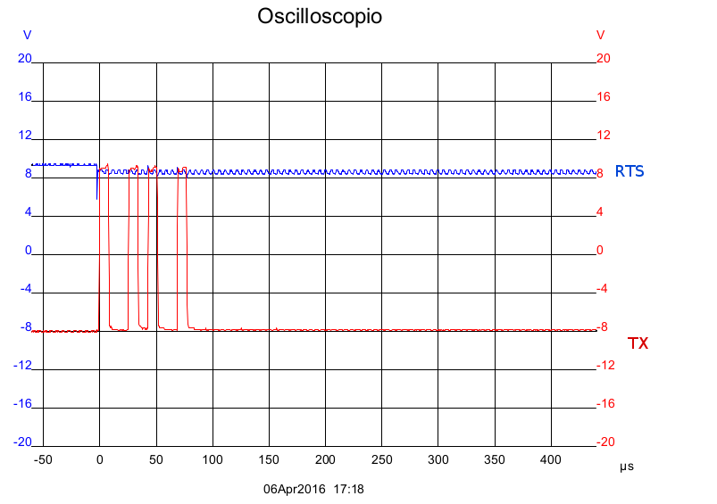

I measured the signals TX,RX,RTS,CTS with a scope directly on the CPU pin (TTL) before the TTL-RS232 converter (I removed it)
The signals operate in the same manner and I didn't notice any swap on their behaviour.
The result of my test is that if I enable dte-mode in the DeviceTree I don't have any data out on the TX line
This is what I see transmitting a single char using minicom with a PC
When I use the iMX6 based board (/dev/ttymxc2) the RTS line is the same (high) but TX is always low and no data exit out.
