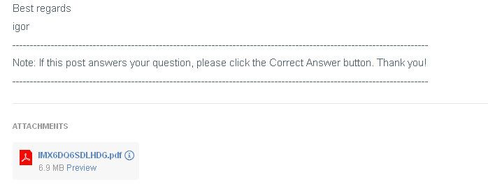

igorpadykov
Hi Joachim
attachment in red in previous answer (IMX6DQ6SDLHDG.pdf), please click with mouse on it
igor
