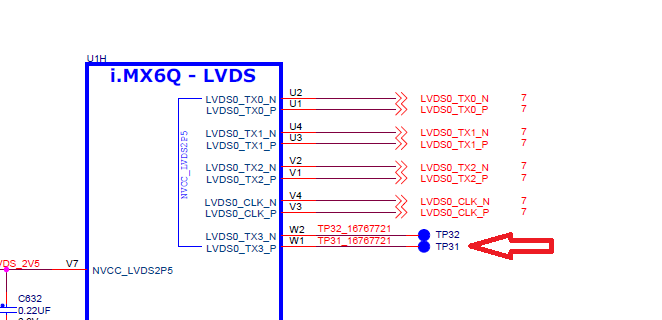

We are using imx6Q custom platform for our development which is based on sabresd platform.
We are using Linux 3.14.28_1.0.0-GA BSP for our development.
Our primary display is connected with LVDS0. The pixel format is RGB24 and bpp is 24. With this display, we are not able get the Yocto GUI.
In addition, we have tested with another display (RGB666 & 16 bpp).  Here we are able to get the Yocto GUI.
Please let us know, why the YoctoGUI is not able to get in 24bpp display?

i.MX6 SabreSD board only support up to 18 bit.
Need rework hardware to support 24bit by wiring out the LVDS0 TX3 from test point.

Ansari
Dear Biyong sun,
Thank you for your input on our issue.
Our custom board, the LVDS0 TX3 lines are connected properly.
Please suggest us to proceed further.

Have you tried the uboot parameter pass to the kernel.
you need to tell kernel the "if" is RGB24.
video=mxcfb0:dev=ldb,bpp=32,if=RGB24
For the timing for the LVDS panel, please check the devices tree bindiing guide.
And make changes according to the datasheet of the lvds panel.
Documentation/devicetree/bindings/staging/imx-drm/ldb.txt
Documentation/devicetree/bindings/video/display-timing.txt
Actually, the uboot "if" also can use the fsl,data-width in device tree to define.
