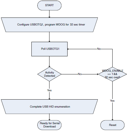

In the figure 8-2 of i.MX6 Quad/Dual reference manual <http://cache.freescale.com/files/32bit/doc/ref_manual/IMX6DQRM.pdf>, it shows USB boot flow. Is it only apply for BOOT_MODE[1:0]=01? Or also apply to enter serial downloader by boot fail from SPI NOR/eMMC/NAND/... in BOOT_MODE[1:0]=10?

Hi m.c.
yes this also applies when entering serial downloader by boot fail from
other modes.
igor
