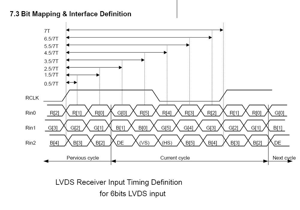

I'm in the planning stage of a project and it would seem the i.MX6 SoloX would fit the bill.
However I would need to integrate this chip on the board: http://www.ti.com/lit/ds/symlink/ths789.pdf  which communicates through an LVDS serial port with its host. Is there a mean to "plug" that easily into the i.MX6 SoloX ? How would that work ?
     Xav
1,632 Views
igorpadykov
Hi Xavier
in general one can connect non-LCD devices to i.MX6 LDB port, however
they should emulate protocol used by lvds LCDs, like below (LCD used with i.MX6 Sabre boards)
http://boundarydevices.com/wp-content/uploads/2013/06/HSD100PXN1-A00-C11-1.0.pdf
also it is not possible to read data from such device (only write). For that reason I am afraid
it is not possible to use THS789 as it uses different protocol.
igor

1,632 Views
xav
OK I get that, thanks.
But is there another mean to connect an LVDS chip to the iMX6 ?
1,632 Views
igorpadykov
Seems most simple is lvds to cmos translator
