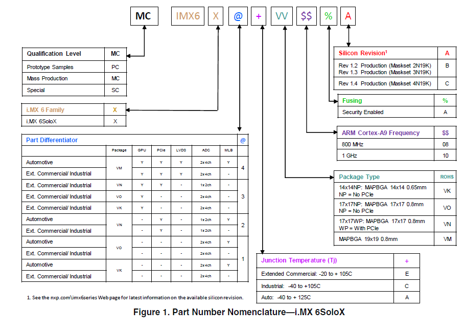

I have been studying about i.MX6 SoloX Boot .
I found this is IMX6SXRM document.
 Silicon Revision 1.4 and later, the
FORCE_INTERNAL_BOOT has been implemented. This fuse
causes the BOOT_MODE inputs to be ignored and the boot
ROM will force the boot mode to “Internal Boot”.
But I cannot find where the Silicon Revision is.
I guess It's related to hardware and maybe part name indicates this Silicon Revision.
But I don't know yet.
Can you please tell me how to find my i.mx6sabresd board's Silicon Revision?

Yes, you are right, it's the chip version. You can see the datasheet
1.1Ordering Information
https://www.nxp.com.cn/docs/en/data-sheet/IMX6SXCEC.pdf
