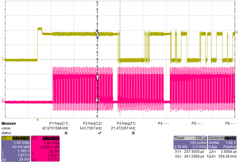

Customer found boot from eMMC fail and has two diagrams for boot okay and fail as below. In this design, only XTAL 24MHz is used and no RTC_XTAL. Is this fail because of ERR007927?
boot_success
boot fail

Yes, the effect of the ERR007927 erratum is the likely cause of the issue.
