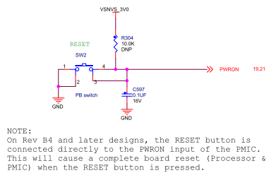

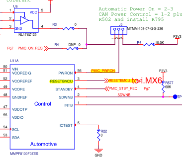

Hello Champs,
Design of i.MX6QDSabreSD board was changed to reset both i.MX6 and PF0100 at a time.
I guess because it had turned out that PF0100 needs to be reset with i.MX6 because of DVFS.
Regarding Sabre AI, it has several ways to reset.
If it uses DVFS, PMIC and i.MX6 also need to be reset at time using following reset line for example.
Correct?

Hello Nori Shinozaki,
we can understand "reset" like this:
(1) Cold Reset
If the reset is caused by PMIC( or we can say power), we can call it cold reset. At the time, all power rails on board will be off , then all on.
(2) warm reset.
Just pull down POR pin of CPU, all powers are on-line, we can call the way "warm reset". the way is just to reset CPU, not include PMIC.
(3)RESET_MCU PIN on PMIC
the pin is used to reset CPU, when all powers are ready on PMIC , PMIC will output a reset signal to CPU, the action is called Power On Reset(POR). Almost every CPU board has POR circuit!
Hope above can help you !
Weidong

Hello Weidong,
Thank you for clear explanation!
