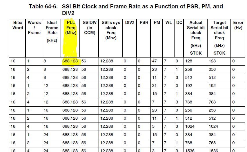

Hi All,
I am checking the datasheet of i.MX6 for the SSI interface, i saw there is a PLL freq 688.128MHZ shows in the table 64-6 as following picture, i am wondering how they got that frequency?

     I saw audio PLL from CCM, I think its freq is set like this: PLL output frequency = Fref * (DIV_SELECT + NUM/DENOM), there are NUM and DENOM can be set to different value, so I think it is possible to get 688.128MHz. such as , DIV_SELECT = 28, NUM = 672, DENOM = 1000, then PLL output will be 24MHz * 28.672 = 688.128MHz. And SSI can be sourced from audio PLL.
