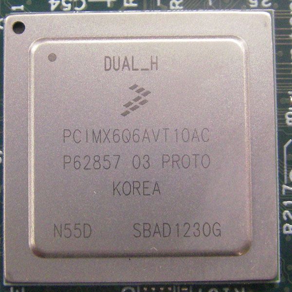

I want some information on my SABRE board (MCIMX6Q-SDB) I bought several weeks ago.
Although it has i.MX6 Quad, when I boot it, I found it's operating as dual core.
(Invoking "cat /proc/cpuinfo" showed that the CPU is operating in dual core mode (see the result below).

Added to that, the CPU has an engraving "DUAL_H" as shown below.)
So, I suspect 2 of the 4 cores are "killed" due to some reason.
And my question is: is this within specification of SABRE board or can I have this replaced with "true" quad version of the board?

igorpadykov
i.MX6Q can be set to work as Dual using kernel boot parameter maxcpus=2
(limits the kernel to using 'n' processors). It may be recommended to use Demo Images:

Thank you for your reply, but I'm afraid that is not the answer I was looking for.
The problem is even though the "maxcpus=2" parameter is NOT specified, the i.MX6 Quad is operating in dual core mode.
But I want this to function as quad core.
For additional information, when I tried the same thing with another SABRE board (of course, with the same Freescale Demo Image), it was operating as quad core as expected.
(In this case the i.MX6 does not have "DUAL_H" engraving.)
Do you have any idea? & let me know if you need more information.

t_kuha
After contacting local distributor, suspicious units were replaced with correct ones (i.e. with the CPU operating as Quad).
