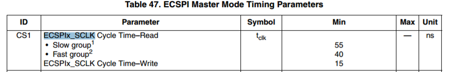

Hi All,
Can we use a flash memory which has 104MHz supporting frequency (Device support high performance command for this frequency) with imax6 quad processor. Manufacturer part number - SST26VF032B-104I/MF
In imax6 DQIEC it has mentioned following under the ECSPI. So what is the maximum supporting frequency for ecspi clock ? What we should look for when we select flash memory for imax6 quad processor ?
Peter.

  please look at the following FAQ :
https://community.nxp.com/docs/DOC-95461
