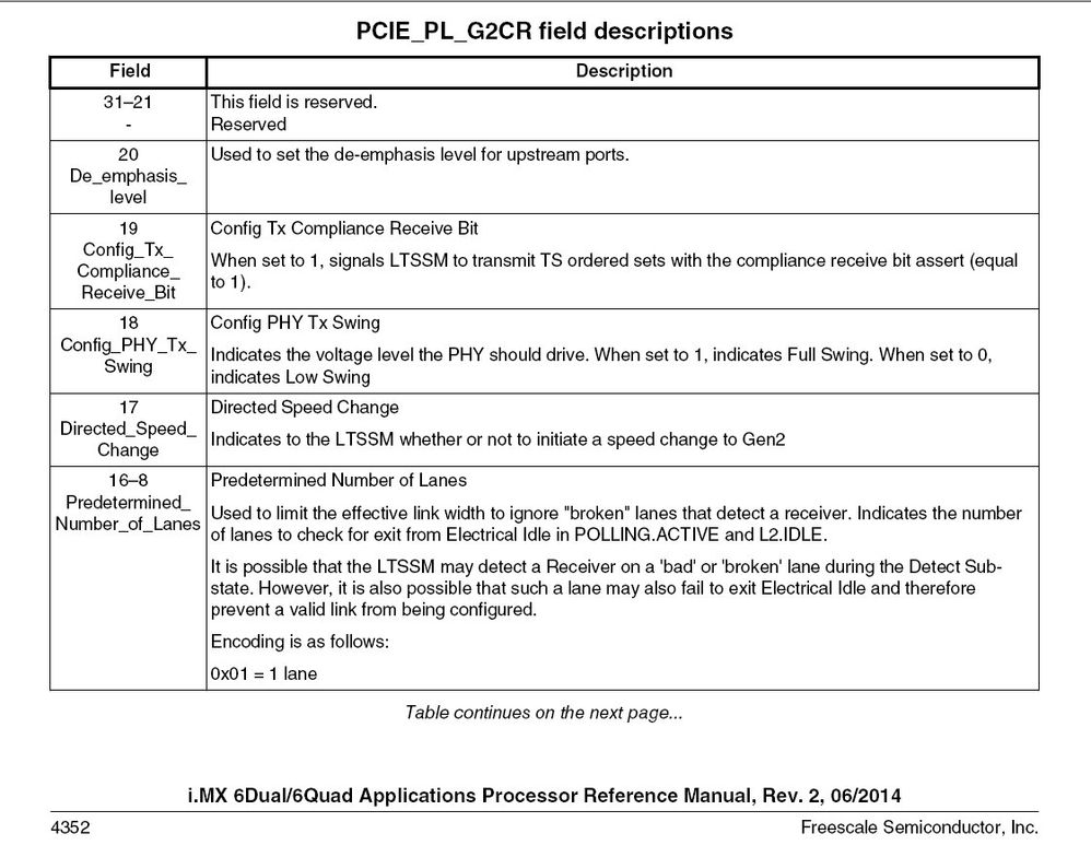

According to the GPR8 register (shown below).  It makes reference to "when pipe0_tx_swing is set to 1'b0".  Does anyone know where pipe0_tx_swing (and pipe0_tx_deemph) are set?
Inline image 1
thanks!
Curt

igorpadykov
Hi Curt
this is Config_PHY_Tx_Swing
igor
