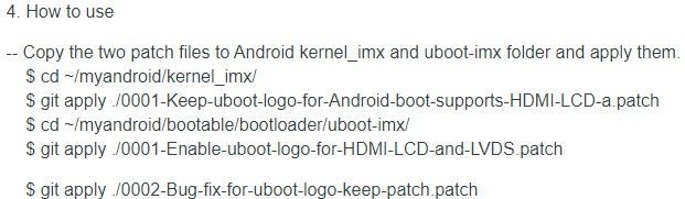

When switching from uboot to kernel based on the Linux, the LCD screen will flash. How to keep the logo display continuously?
Note: I know the reason The LCD is initialized again in the kernel, which results in a flash screen.
Addtionally, I find some patch on the NXP Community, but I don't know how to use the patch and which patch I should use. Moreover, I don't find the i.MX6ull's patch which can solve the problem of flash screen on the NXP official website.
Note: Linux version 4.1.15 (root@cz-VirtualBox) (gcc version 4.9.4 (Linaro GCC 4.9-2017.01) )

ipu patches can be found on below link:
https://community.nxp.com/t5/i-MX-Processors-Knowledge-Base/Patch-to-support-uboot-logo-keep-from-ub...
For i.MX6UL which has not ipu, unfortunately I am not aware of similar patches, sorry.

I think the article which is for Android kernel_imx, because I can't follow the above method to use the patch.(I use the NXP Linux, and I don't find the routine,such as ../kernel_imx, uboot-imx)

After reading Qiang's article which you provide the link, I think the patch can't work on the i.MX6ULL, Qiang say that "The iMX6UL has no IPU hardware, so this patch will not work on it.
The iMX6UL used LCDIF, it is a simple display controller, you just need enable it in Uboot and avoid kernel re-initialize it."
Do you konw how to avoid kernel re-initializing?
