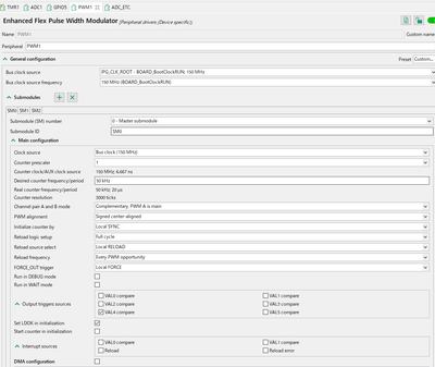

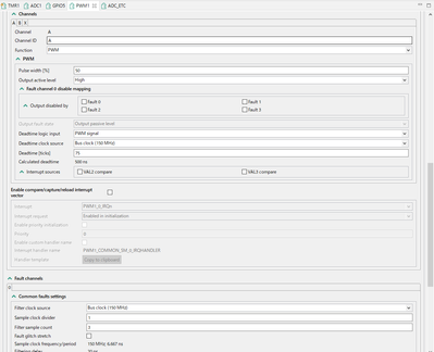

I would like to know the edge of the PWM output and the timing of VAL during complementary PWM.
There is little information in the document, and I would like to know the timing in the PWM mode I use.
[My PWM Setting]

I'm not sure that I understood correctly, so please correct me if I'm wrong. Are you trying to know the value of the VALx registers, right? If so, these values are set inside the function PWM_SetupPwm. You can debug your application and see how these registers are being configured.
Victor
