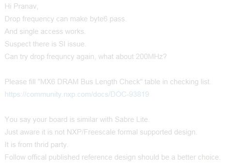

Hi LinWang‌,
We are working our custom board with iMX6 Quad processor. On trying the DDR3 calibration for 1GB with DDR Stress Tool V2.70 using GUI we are getting an error as: ERROR FOUND, we can't get suitable value !!!!
We have been working to resolve this for long time but unsuccessful.
thanks for the help in advance. The log is as below:
Density per chip select: 1024MB

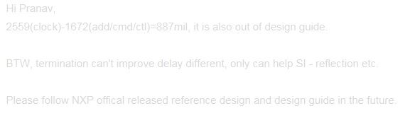

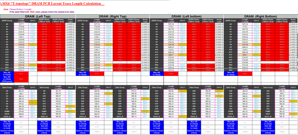

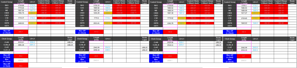

Hi Pranav,
Please consider Yuri's comments.
Seems you miss one question below.
1. How many boards see this issue?
If you can guarantee design is fine, then we will focus on soldering and DDR device.
In order to reduce effort, let's check low 16bit only.
Suggestions:
1.  change a new DDR chip on lowest 16bit.
And using Scritp aid and generate 16 bit script for debug.
https://community.nxp.com/docs/DOC-94917
2. change DDR chip from another vendor.

But still my u-boot is not booting. I am getting jump to address message, but there are no messages on the console. any suggestions?
3,660 Views
LinWang
3,660 Views
pranavparmar
Hi LinWang‌,
I understand that termination won't help for the delay. I have configured MMDC0_MDMISC = 0x000117C0 to compensate the delay. But still byte 1 is not successful.
Is there any other way to rectify the issue?
Thank you in advance.
3,660 Views
LinWang
Hi Pranav,
Two suggestions for lowest 16 bit bus:
1. Do SI siumlation to check your PCB layout.
2. Do compliance test and see if there are some SI issue.
3,660 Views
pranavparmar

Also I have attached images of my Design checklist Layout details. I see many issues with address and command lengths so I have used a termination IC with 50 ohms pullup for it. I wish you could highlight most critical ones that may cause the issue.
Pranav
