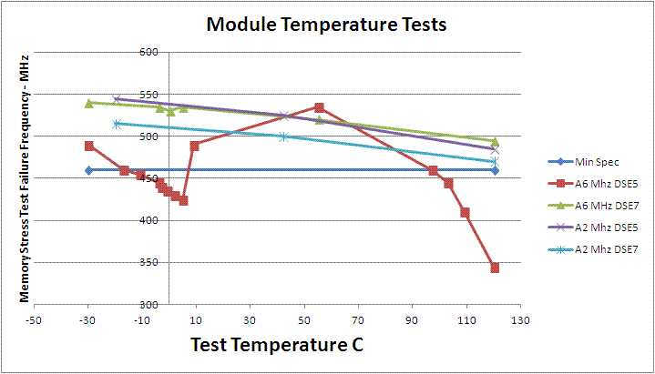

We have a large (noisy and power hungry) Temperature Test chamber here, that can test from -40C to +180C. I needed weeks of testing to gather the data I needed.
Here's how complicated it gets. The following shows the "best" and "worst" boards that we found during limited testing.
"A2" and "A6" were the last bytes of the hex Serial Number of the boards.
The light blue and purple lines show the temperature response of the "good board" (Serial A2) with the Drive Strength set to "5" and "7". At all temperatures it ran the stress test above 460MHz memory Clock speed. Setting it to "7" made it fail at a lower clock rate, but still well above the 400MHz it normally runs at.
The Red and Green lines show the failure temperatures of the "bad board" (Setial A6). It ran better at a Drive Strength of "7" than the other board did at "5", but looks at what it did when set to a drive strength of "5". It failed at 420MHz at 5C and at 400MHz at 110C.
Before we ran these tests, the default setting of the board as designed was "5". We were able to prove that a setting of "6" improved the "bad boards" without dropping the performance of the "good boards" over much.
