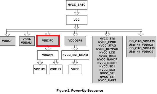

I'm creating i.MX502 power-up sequence by referring to SDG and the EVK schematics.
I found 3.15V including VDD3P0 is supplied by DC/DC, not by MC34708.
Then it looks the DC/DC is enable by GPIO after the CPU core startups.
Is this correct?
In the case, the VDD3P0 is almost the last to be enabled
Are VDD2P5, VDD1P8, VDD1P2 Ok to be enabled before VDD3P0?

VDD2P5, VDD1P8, VDD1P2 should be enabled after VDD3P0
as shows Figure 2
Note there may be discrepancies between reference design and datasheet
descriptions since reference design is created before datasheet specs
are finalized.

some clarification is given at footnote 2
to IMX50CEC sect.4.2.1 Power-Up Sequence
2). No power-up sequence dependencies exist between the supplies shown
shaded in gray.
However VDD2P5, VDD1P8, VDD1P2 should be enabled after VDD3P0
as shows Figure 2
are finalized.
igor

I'm concerned on the following VDDs, not on the shaded ones
In the EVK, VDD2P5, 1P8, 1P2 are enabled prior to VDD3P0.
as shows Figure 2
are finalized.

I see, thank you!
