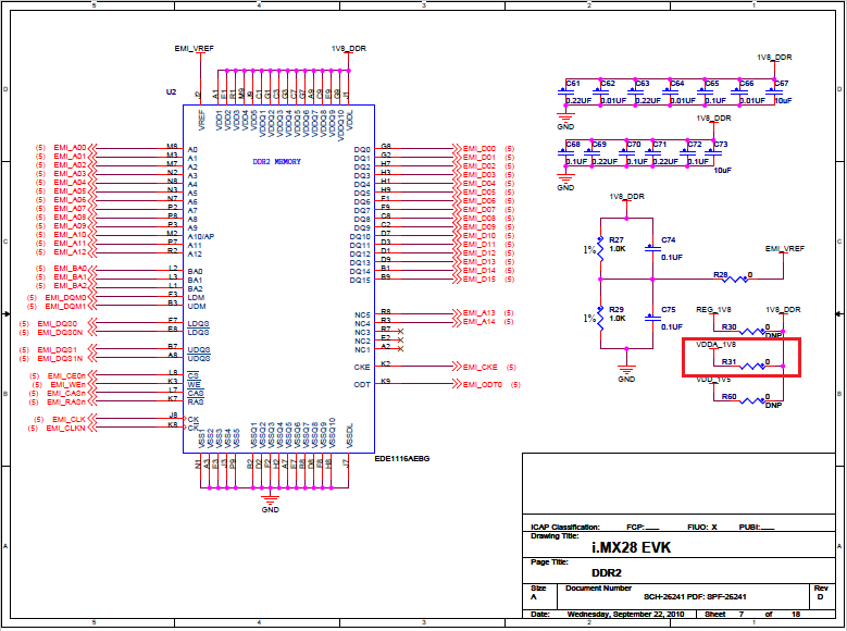

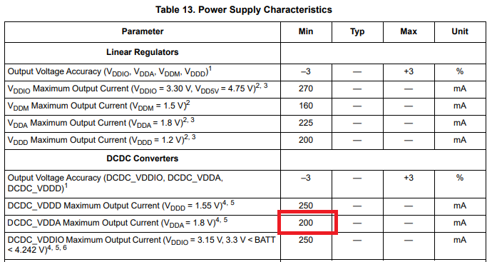

VDDA, which is the DDR source from i.MX287, can supply maximal 200mA for DDR2.

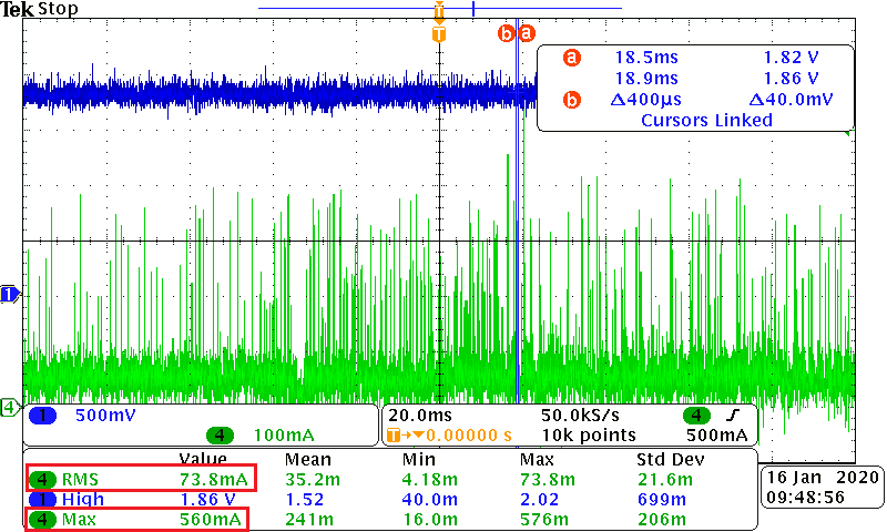

After measuring current through R31 on i.MX28 EVK, RMS value is under 200mA but peak value is around 560mA.
Ch1 is the voltage of VDDA_1V8, and Ch4 is the current through R31 on i.MX28 EVK.
What kind of value can stand for VDDA maximal output current? RMS, peak, average or else?
If this 200mA is RMS value, I can select W971G series which is same as i.MX287 EVK, and everything meets specification.
If this 200mA is peak value, I want to know the design concept of i.MX287 EVK. Why is this current value over specification?

Do you mean the peak value of DDR load current should be under VDDA maximal output current and it is also acceptable even load current over the maximal value? And, what type of value is the maximal output current?

The peak value of DDR load current is out of the i.MX287 VDDA output maximal current, but the RMS value is within the maximal output.
I need to make sure there would be problem in the future, so clarify what type of the maximal output current is very important.
If there is no any confusion of EVK, then I will use EVK as reference design. Or, I think the EVK schematic circuit may have potential problems.
