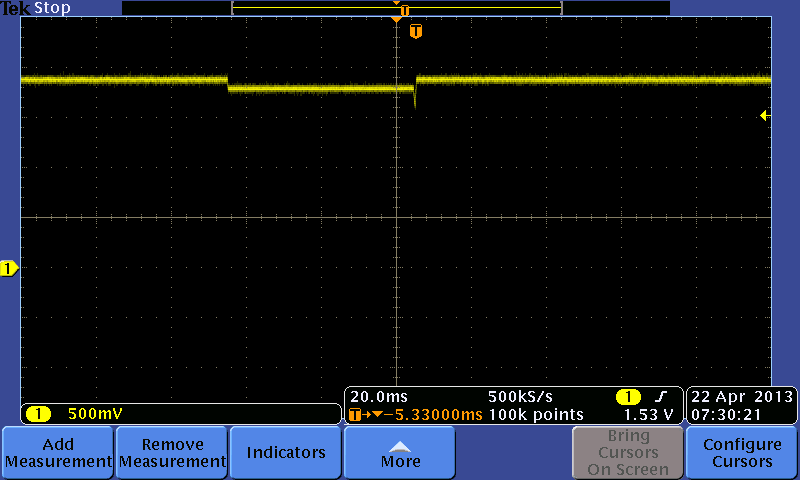

rabryn
I have more information about this issue.  I've come to the conclusion that u-boot is broken for iMX28 designs that implement section 4.1.2.1 of AN4199 (see my first post for more info).  If I apply the previously mentioned patch to the Freescale bootlet code I see a solid 1V8 rail on my DDR for instance, u-boot does not properly initialize the rail voltages in this configuration.  Here's an oscope screen shot of the 1V8 when u-boot initializes the power supply...
I've modified u-boot/arch/arm/cpu/arm926ejs/mxs/spl_power_init.c to force the iMX28 to use the 5V supply like the following but no luck (removed battery check and battery brown out initialization).
static void mxs_power_configure_power_source(void)
        struct mxs_power_regs *power_regs =
                (struct mxs_power_regs *)MXS_POWER_BASE;
        struct mxs_lradc_regs *lradc_regs =
                (struct mxs_lradc_regs *)MXS_LRADC_BASE;
        mxs_src_power_init();
        /* 5V source detected, bad battery detected. */
        writel(LRADC_CONVERSION_AUTOMATIC,
                        &lradc_regs->hw_lradc_conversion_clr);
        clrbits_le32(&power_regs->hw_power_battmonitor,
                        POWER_BATTMONITOR_BATT_VAL_MASK);
        mxs_5v_boot();
        mxs_power_clock2pll();
        mxs_switch_vddd_to_dcdc_source();
If anyone has any suggestions as to how to fix this issue I'd be happy to try them.

rabryn
Fabio,
Yes, you are correct.  More importantly though, if I apply the patch to the bootlet code I see a solid 1V8 on my DDR2 rail... the thrashing you see in the oscope screenshot above is gone.
