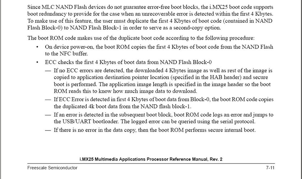

igorpadykov
HI 王剑翰
one can try to implement procedure described in RM below
igor

We also checked this document. As you see,
If ECC Error is detected in first 4 Kbytes of boot data from Block-0, the boot ROM code copies
the duplicated 4k boot data from the NAND flash block-1.
So our engineer try to modify forcibly the ECC check value of block0 to illegal by ATK to simulate block0 failed. But they found i.mX257 also boot from Nand flash block0. Maybe this is not good way to simulate block0 fail.
Couly you have better method to do this?
