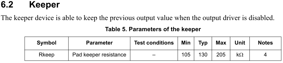

With internal Keeper enabled, how much current should I give in order to driver the pin low?
I don't understand the question well but I think internal Keeper load doesn't effect on the current to drive the pin.
However from AN5078 "Influence of Pin Setting.." document describes Keeper has Typ 130K load.

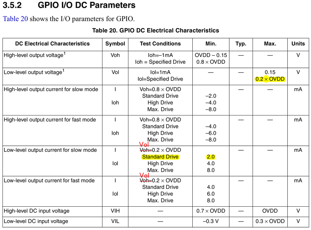

From i.MX25 datasheet, Iol is 2.0mA for slow mode and Standard Drive GPIO pins.
So in order to drive the pin Low, minimum 2.0mA can be input to i.MX25.

Unfortunately, I don't understand the question exactly. When the pin is configured as GPIO input with keeper disabled (default state of most pins out of reset), it behaves as hi-Z, so, any pulldown resistor (even 1MOhm) can keep it Low. When the pin is configured as GPIO input with keeper enabled, it behaves as equivalent resistance of typ. 130kOhm as you listed, connected to the current state level. In this case, 10kOhm pulldown should be enoug to always pull the pin over to Low state. If the pin is configured as GPIO output, trying to drive it externally to pull it over to another state is not a good pratice that can lead to permanent GPIO driver damage.

Without considering Keeper impedance, do I just need to refer to IoL in the table 20?
For example, in "slow mode" and "Standard Drive", the GPIO can pull in Min. 2.0mA for VoL.
If we drive 2.1mA, the pin goes above VoL?

Q. Without considering Keeper impedance, do I just need to refer to IoL in the table 20?
A. Yes, you are right.
Q. For example, in "slow mode" and "Standard Drive", the GPIO can pull in Min. 2.0mA for VoL.
A. Typically no, but it is not guaranteed to drive more than 2.0mA for these conditions.
