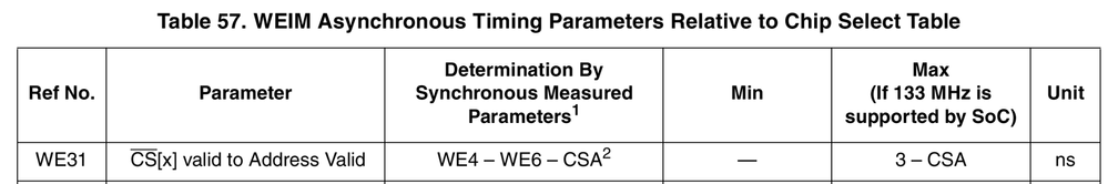

Hello Champs,
I'd like to get WE31 from a table from i.MX25 datasheet below
My CSA is 2, which equals to 1 BCLK = 125MHz = 8ns.
The Max value becomes -5ns.
Is this correct understanding?
Nori Shinozaki

Yuri
  Your understanding is correct . CS is asserted later than address.

norishinozaki
Contributor V
Hello Yuri,
You mean WE4-WE6-CSA is correct and the MAX 3-CSA = -5ns is also correct value?
Nori Shinozaki
1,268 Views
Yuri
yes.
