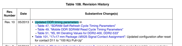

In the Rev 10 Datasheet:
I looked through Rev 0 to Rev 9 data sheet but I can't find any differences in the following two tables.
– Table 47, “SDRAM Self-Refresh Cycle Timing Parameters”
– Table 49, “Mobile DDR SDRAM Read Cycle Timing Parameters”
Were there really changes in spec?

Yuri
   Yes, there are no changes in the mentioned tables. I will inform
the doc team about it.

Hello Yuri,
Thanks!
