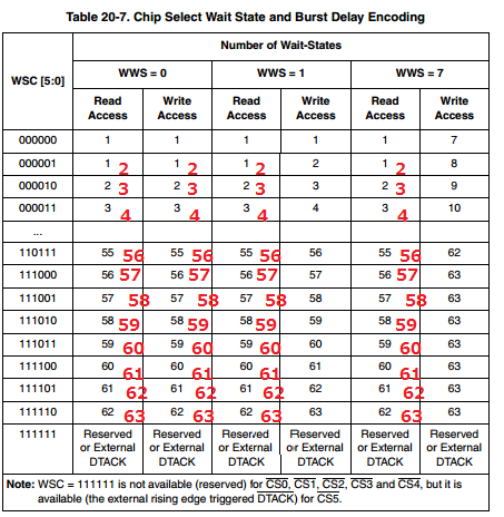

I would like to determine wait cycles in EIM in i.MX21.
I'm setting WWS=0, WSC=111110 checking with MC9328MX21RM Rev.3, however it's not clear which is correct clocks, 63 or 62.
In the RM,
  Table 20-6. 63 clocks: "WSC=111110 results in 63 clock transfers"
  Table 20-7. 62 clocks: "WSC=111110 WWS=0 Read Access 62"
In the 20-7, 63 is Reserved so 62 is the corrcect clocks?

Hi Nori
correct description is given in  Table 20-6 :
"WSC=111110 results in 63 clock transfers",
that is WSC encoded data results in +1 number of wait-states:
WSC = 000001 results in 2 clock transfers
WSC = 001110 results in 15 clock transfers
WSC = 111110 results in 63 clock transfers

Let me confirm, you mean the table value is typo.
The below is the correct one.
Right?
Nori Shinozaki
2,233件の閲覧回数
igorpadykov
Hi Nori
yes this is right.
