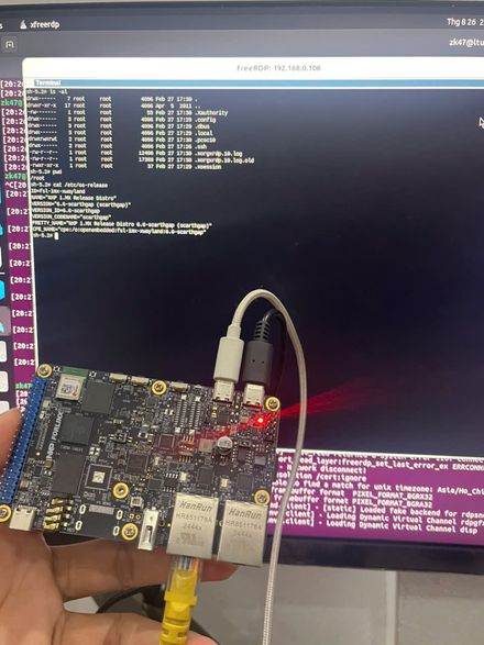

Hi all,
I’d like to double-check my understanding about display support on i.MX91 (FRDM board).
  • From what I can tell, the i.MX91 FRDM has no HDMI or MIPI-DSI (or other display) outputs on the board, and I’m not seeing a display controller exposed by the SoC in the BSP.
  • My goal was to run a lightweight GUI remotely just for testing Yocto apps.
What I tried
  • Built core-image-sato (X11) and set up xrdp. The RDP session connects, but I only get a terminal session (no Sato desktop).
  • Doing the same workflow on STM32MP157 produces a proper remote GUI, so I’m trying to understand what’s different/unsupported on i.MX91.
Questions
  1. Can someone please confirm whether i.MX91 (SoC + FRDM board) has no hardware display controller / no supported display outputs (HDMI/MIPI/LVDS/RGB) in the current BSP?
  2. If there is truly no display pipeline, what is the recommended approach for a headless GUI on i.MX91? For example:
    • Weston headless backend + RDP/VNC backend,
    • Xorg with Xvfb/Xdummy + xrdp,
    • or any NXP-recommended method that works with the i.MX91 graphics stack (e.g., software rendering via llvmpipe).
  3. Are there any reference designs or add-on boards for i.MX91 that provide a supported display interface? Or is display only available on other i.MX9 variants (e.g., i.MX93)?
Environment (for context)
If anyone’s interested in the exact steps I used for the RDP setup on i.MX91, I’m happy to share.
Thanks!

i.MX91 FRDM only support 5-inch Tianma LCD display by default on our BSP.
Please refer to the Board User's Guide:
https://www.nxp.com/webapp/Download?colCode=UM12262&isHTMLorPDF=HTML
Chapter 3.1 5-inch Tianma LCD

Actually i know about this screen, but it so expensive, the screen price is triple the board price.
So i think i will stick with virtual display solution. Do you think it possible to some kind of port forwarding or screencast framebuffer to output GUI to xfreerdp from PC.
