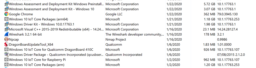

errolleighton1
Here are the SDK versions currently installed on my machine. The ADK, WDK and IoT Core Packages are all v. 17763.

Frantisek_Prochaska
Now the WDK and ADK version seems to be the thing. Hope the update will help.
Let's see the documentation, eg. User's guide provided (chapters 10.1.1.2 and 10.1.1.3) or the archived Microsoft Readme:
Required tools:
Windows Kits from Windows 10, version 1809
  • IMPORTANT: Make sure that any previous versions of the ADK and WDK have been uninstalled!
  • Install ADK version 1809
  • Install WDK version 1809
    • Make sure that you allow the Visual Studio Extension to install after the WDK install completes.
  • If the WDK installer says it could not find the correct SDK version, install SDK version 1809
IoT Core OS Packages
  • Visit the Windows IoT Core Downloads page and download "Windows 10 IoT Core Packages – Windows 10 IoT Core, version 1809 (LTSC)".
  • Open the iso and install Windows_10_IoT_Core_ARM_Packages.msi
  • Install Windows_10_IoT_Core_ARM64_Packages.msi for ARM64 builds.
