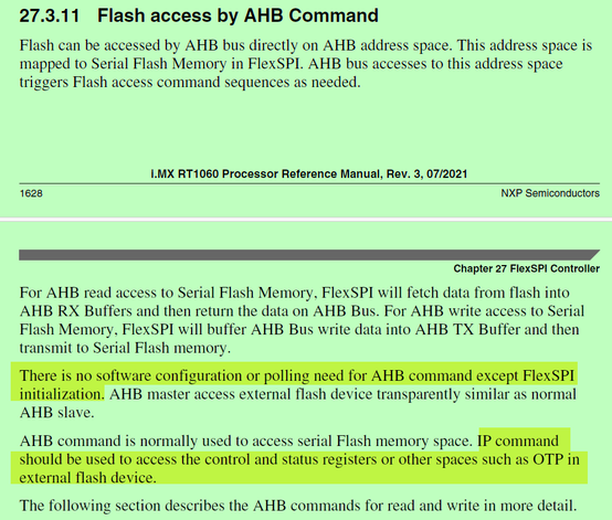

Per my understanding, interrupts are disabled to  avoid any unexpected flash access until write operation completes. Based on this, I would say that triggering an AHB FlexSPI command that does not involve writting ( as reading SFDP commands), should support working along interrupts enabled.  However, testing this on an RTOS environment would be better, as the systick is always interrupting.
I mention AHB commands because this kind of transfer do not require SW to pull as, we need with IP commands
The function you mention does implement IP commands, wich do require SW polling and monitoring.

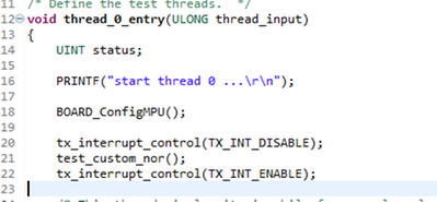

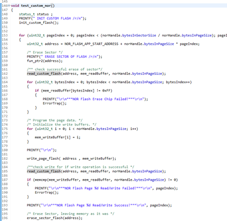

We're running ThreadX, and in our first implementation of reading the JEDEC ID we haven't disabled interrupts (FlexSPI functions are in RAM). We haven't seen any issues, but were concerned with this mostly working, but strictly speaking not being correct use. The "better safe than sorry" approach would be to just disable interrupts, but generally I don't like doing stuff like that without there being an explanation as to why

I understand, I have been there, once I did a Filex and FlexSPI project to create flash based file system. Due to systick I had to temporally disable interrupts.
As you mention I used "'the better safe than sorry" approach,  by putting intialization and RW without interrupts.
