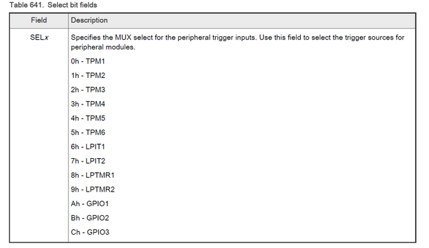

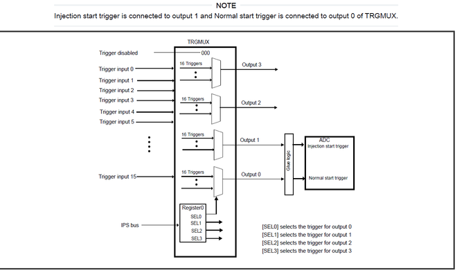

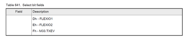

joanxie
you can select by TRGMUX. depends on injection start trigger or normal start trigger you need
different external trigger for SEL0 or SEL1, you can find the table as below

NZP
Hi joanxie,
Thank you very much for your support.
I am able to understand that we can select external trigger from SEL0 and SEL1 register. So, from the table attached by you, value Ah - is for GPIO1 which selects GPIO1 port as an ADC trigger source.
So, my question is that,
1. How I can select/configure GPIO1.IO[0] (or any specific GPIO1 port's pin) as an ADC trigger source.
2. Here I am confused that GPIO1 is one port which has 0 to 15 number pins, so by configuring SEL register for GPIO1 which specific GPIO1's pin will be considered as an ADC trigger source.
