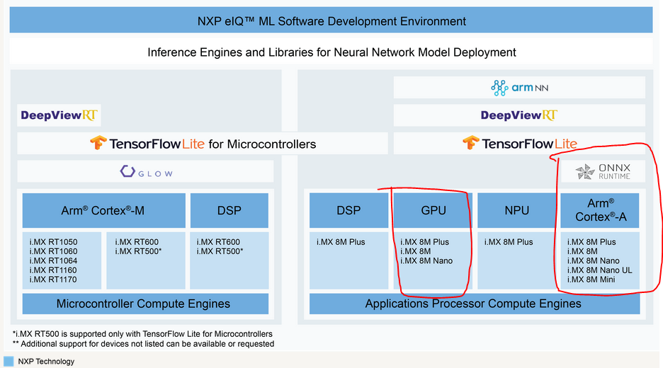

I want to deploy the onnx model on i.MX 8X to perform face detection. But I found that i.MX 8X is not mentioned in the eIQ ML Software Development Environment.
So,
(1) Can the GPU of i.MX 8X accelerate the inference speed of AI models? Is there any reference documents?
(2) Can GPU or A35 of i.MX 8X support ONNX RUNTIME?
(3) Does i.MX 8X support performance optimization for OpenCV?
Expect for your reply.

pengyong_zhang
Hi @ShenYi
>>> No, i.MX8X GPU do not support this.
>>>GOU does not support, CPU can run it.
>>>Yes, i.MX 8X support OpenCV
B.R
