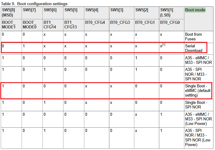

I am using MCIMX8ULP-EVK. If set to SW5[D8-D1]:11xxxxxx, it will not boot.
"Table 78. Boot modes" in the reference manual(IMX8ULPRM Rev. 1, 09/2023) states that BOOT_MODE[1:0]:11 sets the Boot Type to Serial Download.
Attached is the bootlog.txt that failed to boot. And attached is boot_infor.txt with query_boot_infor dumped.
Is this correct behavior?

Serial Download.
U-Boot SPL can boot. But U-Boot cannot start.
I think the cause of this is that rom_api_query_boot_infor(QUERY_BT_DEV, &boot) is set to eMMC boot even though the boot device is specified as USB (Serial Download) boot.

I think you do not set the proper boot mode,You can refer to this:

I think the following two contents are different.
- Table 9. Boot configuration settings
- "Table 78. Boot modes" in the reference manual(IMX8ULPRM Rev. 1, 09/2023)
Which document does this Table 9 appear in? I looked in the reference manual and datasheet, but it wasn't mentioned.
