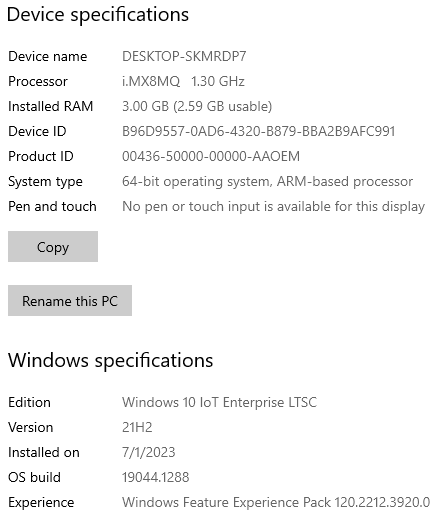

Hi Teams,
Thanks for NXP Teams help, we haved changed i.MX 8M Quad frimware to extend DRAM from 3 GB to 4 GB.
During boot up, we can see debug log as follows.
U-Boot SPL 2022.04-00001-g8a9164f47e-dirty (Mar 01 2024 - 11:33:32 +0800)
Can't find PMIC:PFUZE100
DDRINFO: start DRAM init
DDRINFO: DRAM rate 3200MTS
DDRINFO:ddrphy calibration done
DDRINFO: ddrmix config done
DRAM TIMING NORMAL fixed soc_rev()=21 CHIP_REV_2_1=21
SEC0:  RNG instantiated
Normal Boot
Trying to boot from MMC2
U-Boot 2022.04-00001-g8a9164f47e-dirty (Mar 01 2024 - 11:33:32 +0800)
CPU:   i.MX8MQ rev2.1 1300 MHz (running at 800 MHz)
CPU:   Industrial temperature grade (-40C to 105C) at 30C
Reset cause: POR
Model: NXP i.MX8MQ EVK
DRAM:  4 GiB
setup_typec: tcpc init failed, err=-5
Core:  78 devices, 26 uclasses, devicetree: separate
MMC:   FSL_SDHC: 0, FSL_SDHC: 1
Loading Environment from MMC... *** Warning - bad CRC, using default environment
But when we boot up to the Windows 10 IoT Enterprise LTSC 21H2, we only see 3 GB Installed RAM as follows.
Are we missing any steps?
Thanks for NXP Teams help.

Hi @hector_delgado
So far we used W21H2-1-5-0-imx-windows-bsp.zip to evaluate i.MX 8M Quad (MX8M_EVK).
From very beginning, we want to know how to extend our LPDDR4 memory from 3 GB to 4 GB.
Then NXP Teams help us, during U-Boot period, we can see result is DRAM: 4 GiB.
But when we boot up into Windows 10 IOT ARM64, we only can see Memory: 3 GB.
So we continue to ask NXP Teams for help.
But the end, we have referred other EVK board BSP source code, we have modified partial MX8M_EVK U-EFI source code, now we can boot up into Windows 10 IOT with 4 GB memory.
Thanks for you and NXP Teams help!
