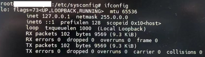

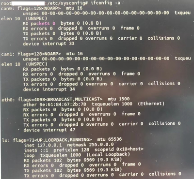

In my design refer to NXP EVK, imx8m plus + RTL8211F is used.
5 PCBs are producted, and only 1 PCB ‘s network card had problem.
as below, when ifconfig, only lo
but when ifconfig -a ,  eth0 is shown.
The communicaiont is failure for PC and RTL 8211.
the remaining 4 PCBs ,have eth0 when using config not ifconfig -a.
please confirm. Thanks a lot.

JosephAtNXP
Hi @www1519,
I assume that your five boards are exactly the same schematic with exactly same part number for every component, am I right?
Seems that PHY is not responding maybe in time or speed, could you scope that the PHY is properly clock-fed and the MDIO lines actually have both-side communication?
Also, check for bootstrapping settings, did you populate the same bootstrap resistors?
Thank you
2,766 Views
JosephAtNXP
Thank you for your interest in NXP Semiconductor products,
Does the PHY still fail when you run this command?
$ ifconfig eth0 up
The IF hasn't the UP flag, that's why it doesn't appear on ifconfig output.
The ping will fail until it has an IP and a RUNNING flag.
