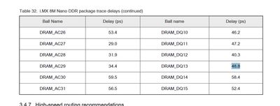

I'm designing  i.MX 8M Nano and DDR4-2400 strongly following the IMX8MNHDG dev guide.
Is there any other documentation/guides/files that would be helpful for me?
Required impedace for CLK and DQS signals , may be some layout checklists ?
Someting like HW_Design_Checking_List_for_i.MX6DQP6DQ6SDL_Rev3.1.xlsx
Also I have found one not critical mistake in  IMX8MNHDG .

Hi Alexander
impedances are provided in sect.3.5 Trace impedance recommendations
i.MX 8M Nano Hardware Developer’s Guide
I am afraid there are no additional documents, in general recommended to use simulation,
sect.3.4.5 i.MX 8M Nano DDR SI simulation guide, ibis models can be found on
https://www.nxp.com/products/processors-and-microcontrollers/arm-processors/i-mx-applications-proces...
