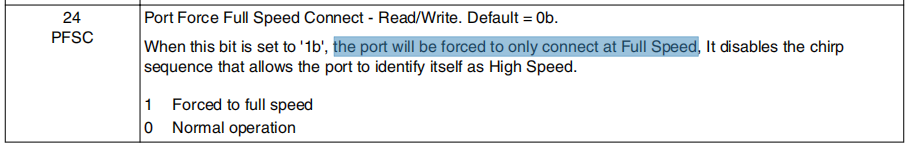

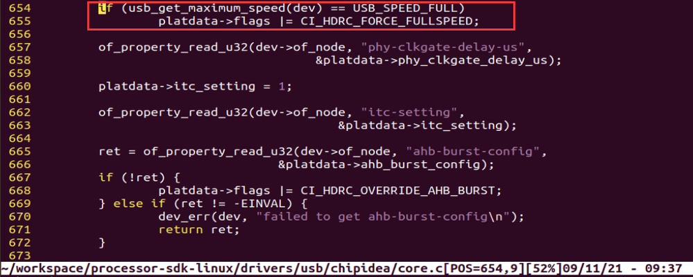

I see in the IMX8 datasheet(USBx_nPORTSC1 register bit of PFSC ) and the Chipidea /core.c:654 driver file that the configuration port is supported only at full speed connection.But,I don't see information in the IMX8 USB register instructions about configuring only low speed connections. 2.png
Does USB OTG support driver configuration to connect only at low speeds?
I am afraid not, sorry.

On other platforms, USB speed can be limited by the “maximum-speed” attribute of the USB device tree node, but no configuration logic for USB speed is found in the IMX8USBOTG driver.  Can I limit the USB speed to low-speed through the driver?  If so, how to configure it?
