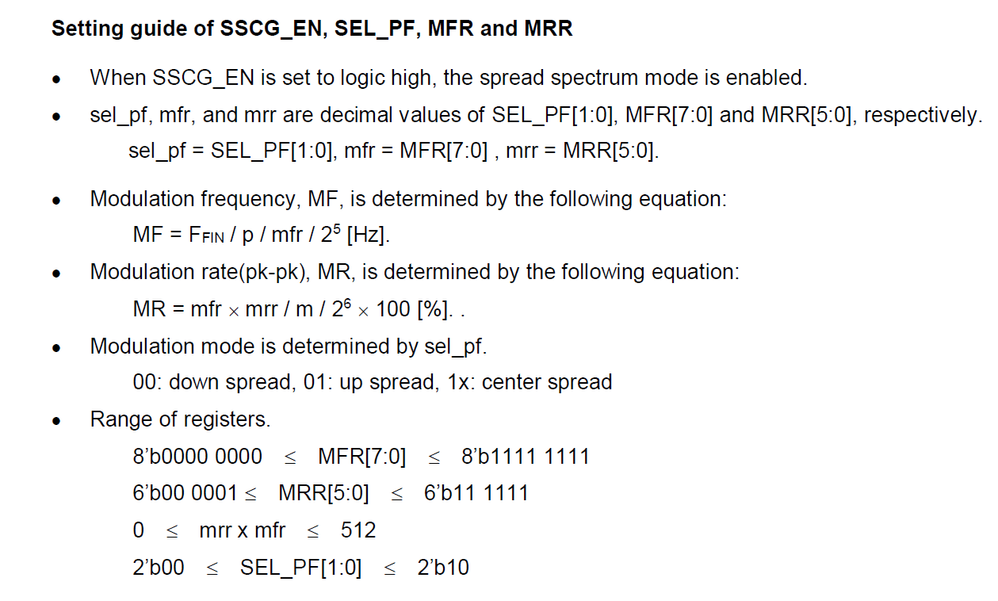

We are looking to implement Spread Spectrum Clocking on the MIPI DSI interface.  It appears there are 2 locations where this can be applied 1) the CCM (as noted here https://community.nxp.com/t5/i-MX-Processors/iMX8M-Mini-Spread-Spectrum/m-p/1024187) and 2) the MIPI D-PHY itself.  Is there an example or more details for how to implement SSC on the D-PHY?  We see the register MIPI_DPHY_M_PLLCTL allows SSC to be turned on and some bits to set the modulation, but no definition of how those bits are used.

See below, please!
Hope above information is helpful to you.
