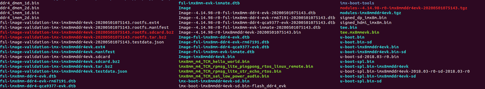

cd ~/git/imx-yocto-bsp-ddr4/build/tmp/deploy/images/imx8mmddr4evk
bunzip2 -dk -f fsl-image-validation-imx-imx8mmddr4evk.sdcard.bz2
sudo dd if=fsl-image-validation-imx-imx8mmddr4evk.sdcard of=/dev/sdb bs=1M && sync

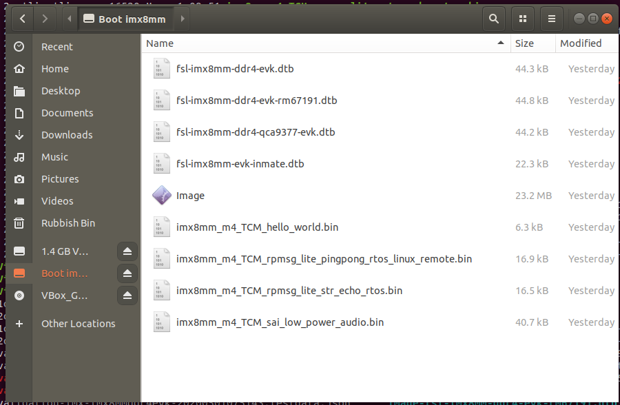

I also tried renaming the Image to zImage as per the assumption in 4.7.1 of the Linux User guide. And lastly under 4.7 I tried running some of the commands suggested, below is the command line prompt, which again suggest a problem with the card.
u-boot=> saveenv
Saving Environment to MMC... !No block device
Failed (1)
u-boot=> run bootcmd
Bad Linux ARM64 Image magic!
u-boot=>

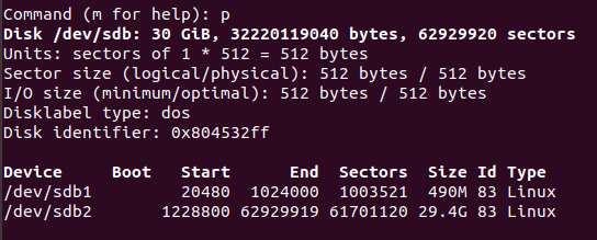

For more information I have also ran fdisk below to show the partitions.

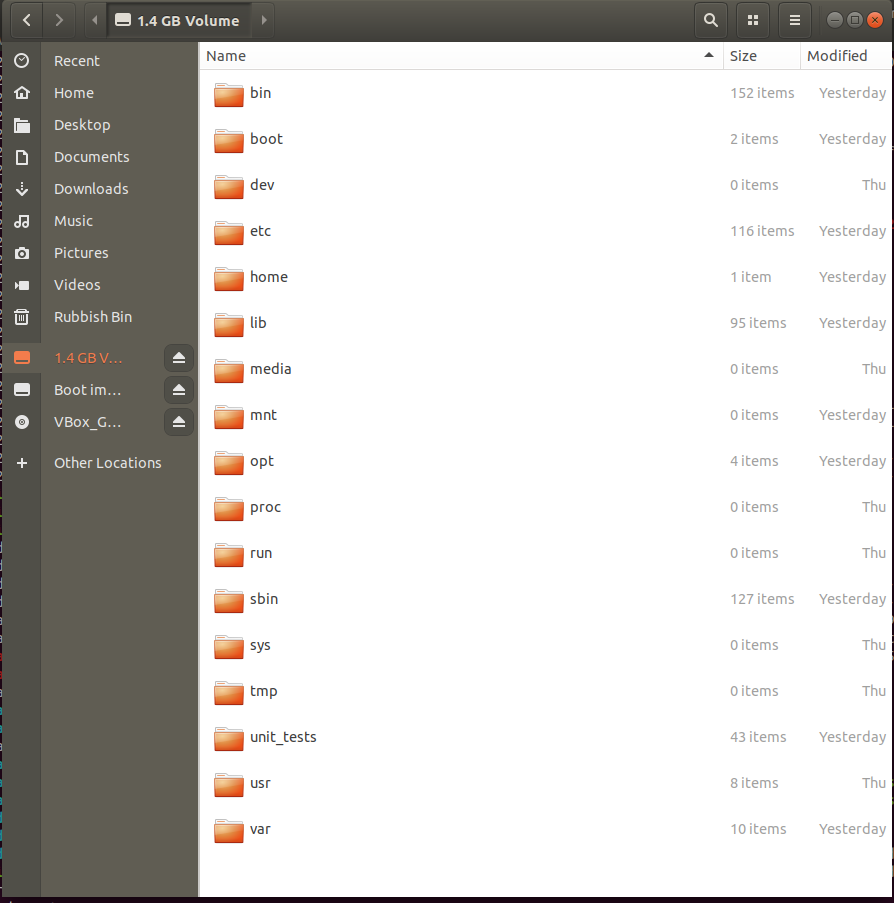

I thought for a moment here that this might be due to the filesystem not being in the correct place as I am using a 32GB SD card or some similar reason. So I went through 4.3 in the Linux user guide Rev. L4.14.98-2.0.0_ga from 4.3.3 onwards. The partitions there are slightly different and I made the card as described (there was one thing I wasn't sure about which was the name of the <U-Boot Image> I used "u-boot-imx8mmddr4evk.bin-sd", and also "u-boot-spl.bin-imx8mmddr4evk-sd"). This way of preparing the card never gave me anything on the debug interface, i.e. it never got into the U-Boot.
Below are the commands I used to prepare the card in the way that didn't do anything. The partition numbers are directly from the Linux User guide chapter 4.3.3

sudo fdisk /dev/sdb
p
d
1
d
n
p
1
20480
1024000
n
p
2
1228800
<enter>
p
w

tar -jxvf /home/user/git/imx-yocto-bsp-ddr4/build/tmp/deploy/images/imx8mmddr4evk/fsl-image-validation-imx-imx8mmddr4evk-20200501075143.rootfs.tar.bz2
sudo cp -a * /home/user/mountpoint

For my third question. Where have I gone wrong in preparing the card manually in the partition table, i.e. why does it not go into the U-Boot and at least get to the same place as the previous one? Bonus question, what is the <U-Boot Image> name (ls output below)?pastedImage_19.png
My thought on the third question was the dtb, however that is never mentioned in the Linux User guide under the SD card preparation chapter. There is also no mention of populating the first partition, which as far as I can tell should be populated with at least the Image, dtb etc. files.

I have ran through it all again re-doing the build and going through the two methods of writing to the SD card presented in the Linux user guide, but I always arrive at the same conclusion, unable to read the kernel image on the SD card.
radhika.somaiya@volansystech.com‌ you mentioned using the pre-built images with the ddr4 names. I have tried creating an SD card using those, however as they aren't as straight forward as a pre-made SD card image I cannot rule out that my process to turn them into a bootable SD card is somehow wrong. Are there any guides on how one should do this? The last thing I tried was to do the commands as:
sudo dd if=fsl-image-validation-imx-imx8mmevk.sdcard of=/dev/sdb bs=1M && sync
sudo dd if=imx-boot-imx8mmddr4evk-sd.bin-flash_ddr4_evk of=/dev/sdb bs=1k seek=33 conv=fsync
Thinking that by writing the file system as per the sdcard image and then later replacing the bootloader section that would help but it came to the same conclusion as everything else I have tried, i.e. the MMC init failed message and only booting into U-Boot.
