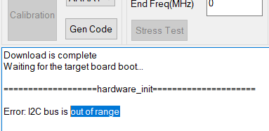

Hello @jan_spurek,
We are developing products using i.MX8M-Puls.
Our board uses the 5th I2C port for connection with the PMIC.
We added the following to the script file for MSCALE_DDR_Tool_v3.31.
#### PMIC Configuration (BUCK6 1.1V to 1.2V) for I2C5 ####
memory set	0x303301D4	32	0x00000002	#IOMUXC_SW_MUX_CTL_PAD_SPDIF_TX
memory set	0x303301D8	32	0x00000002	#IOMUXC_SW_MUX_CTL_PAD_SPDIF_RX
memory set	0x30330434	32	0x000000C6	#SW_PAD_CTL_PAD_SPDIF_TX
memory set	0x30330438	32	0x000000C6	#SW_PAD_CTL_PAD_SPDIF_RX
sysparam set	pmic_cfg	0x0425
sysparam set	pmic_set	0x1E18
But it doesn't seem to work.
The i.MX8M series (excluding PLUS) support 4-ports for I2C.
Only the PLUS has 6-ports for I2C, more than those.
So DDR Tool seems to be unable to use I2C5 and I2C6.
Could you please fix the DDR Tool so that our board can finish the DDR calibration?
It can be a preliminary version that can only use I2C5, we need it ASAP.

Hi George,
thanks for reporting the issue. Indeed, I can see in the source code that the DDR Tool can only work with 4 I2C ports on i.MX8MPlus. Unfortunately, I am not the maintainer of the DDR Tool nor I have the build environment setup on my machine therefore, I need to ask a colleague of mine to help modifying the tool.

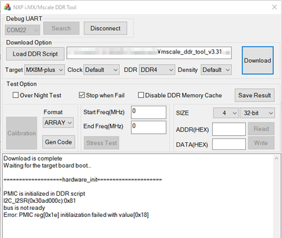

Hello @haidong_zheng@jan_spurek,
Sorry, I couldn't report the results even though you modified the program immediately.
We have reviewed the .ds file and tried various things, but we see messages like this:
I tried to observe the I2C5 waveform with an oscilloscope, but I2C5 remains pulled up and there is no change.
Now I can calibrate by changing PMIC settings from external chip, so fixing DDR_TOOL is no longer urgent.
I'll report back a little later once my research has progressed further.
George
Sorry I was able to figure out what that file is.
Apparently you added changes to use I2C5 and I2C6.
we'll try.
George
