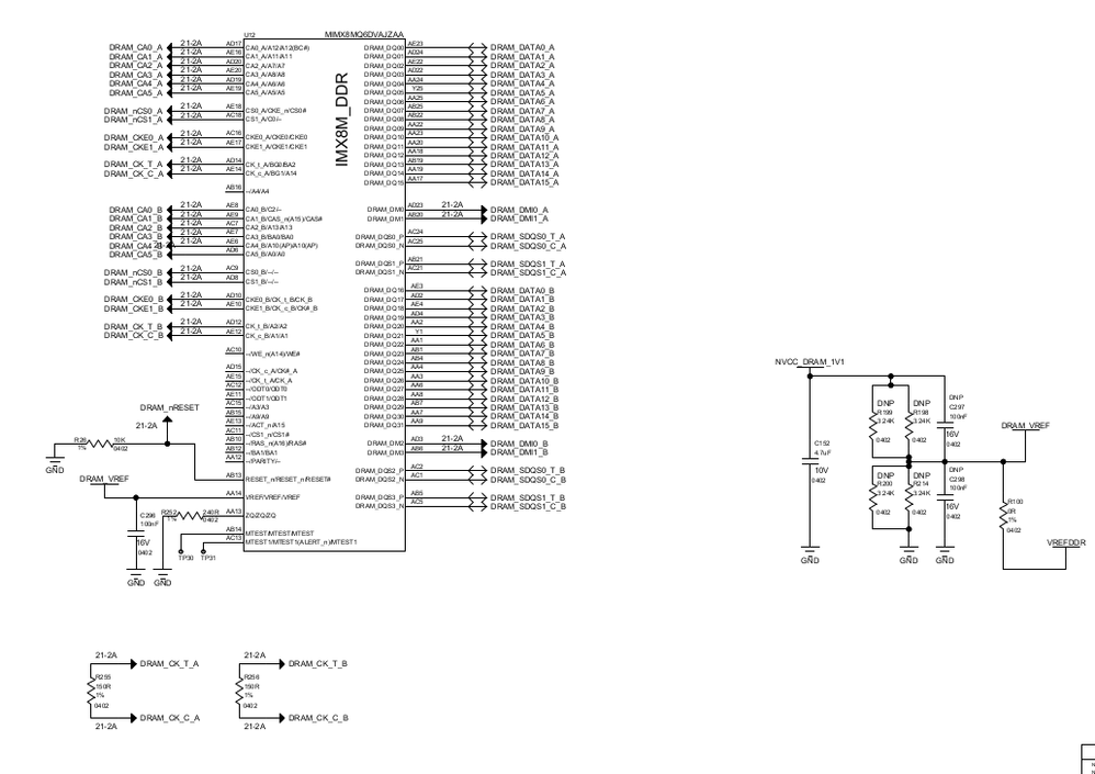

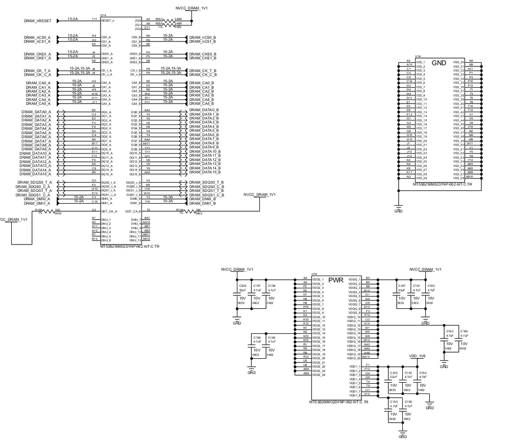

We have designed a custom board with i.MX 8M Quad CPU. We controlled the voltages and clocks on the board. We are using "MT53B256M32D1NP" as LPDDR4 on board which is connected 32 bits bus width. Our boards MT53B256M32D1NP's layout information is given in attachment "ddr_specs.jpg" and DDR Controller Configuration Aid Spreadsheet configuration (RPA) based on MXM8M_LPDDR4_RPA_v24.xlsx is given in attachment "ddr_aid_cfg.jpg" and i.MX side connection schematic is given in attachment ddr_sch.jpg.

If we change the bus witdh to 16 using RPA then the calibration is done successfully but the density of DDR is shown as 512MB as expected.
We could not found our problem. What causes "PMU: Error: RxEn training preamble not found" error? What can do after this point?  Any help appreciated.

We have reviewed the your RPA and no problem is found.
From your description, there is something wrong in channel B of LPDDR4. Please go to check the hardware connection on LPDDR4 channel B.

Thank you very much for your help. By your help we see the problem. Our hardware guys had entered the symbology of DDR's channel pins in different order in DDR connections.
Thanks for your precious time.

Thank you for your interest.I am sorry to inform you that I can not share datasheet of MT53B256M32D1NP because of NDA concerns. But I think I can share the link of datasheet of MT53B256M32D1NP which is  "http://files.pine64.org/doc/datasheet/rockpro64/SM512M32Z01MD2BNP(200BALL).pdf ".
I am attaching the i.MX8MQ (m850) DDR Controller Configuration Spreadsheet that I customized. And the LPDDR4 connection pictures of the schematics of our board.
I can not attach the spreadsheet directly so I am sending the link that I shared the spreadsheet.
