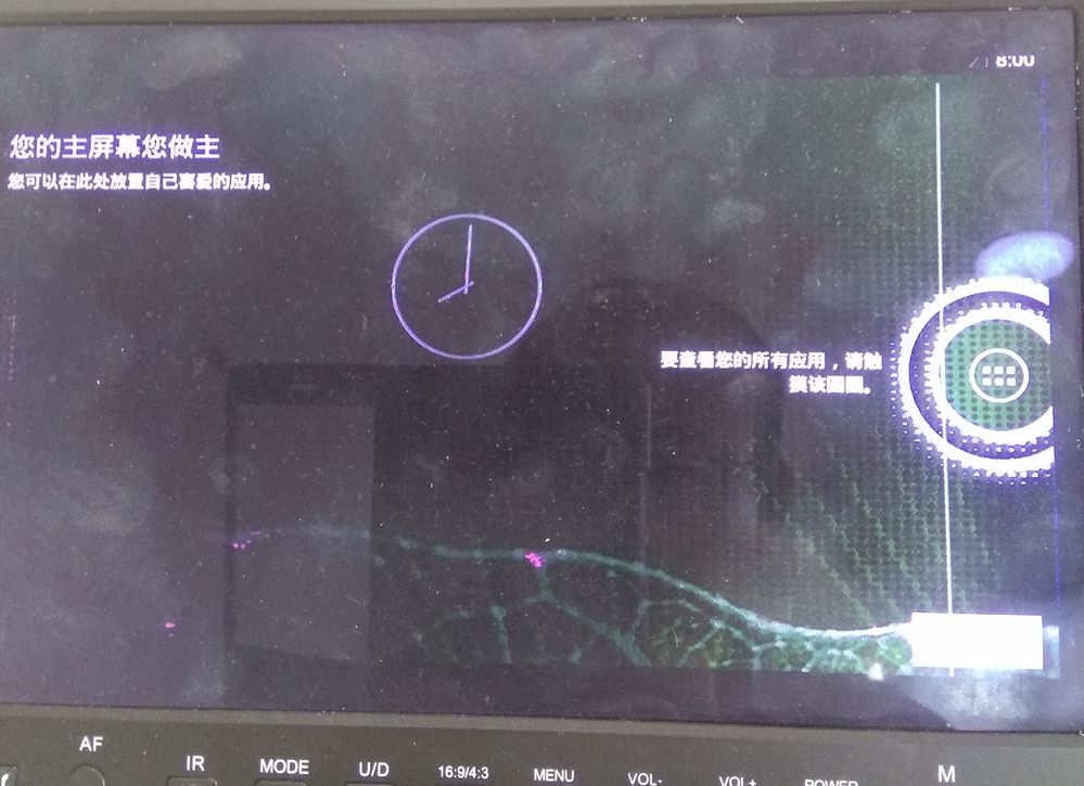

THANS A LOG FOR work;but not right:
next is display with bootcmd: video=mxcfb0:dev=lcd,LCD-1080I50,if=RGB565,bpp=32
next is display with bootcmd: video=mxcfb0:dev=lcd,LCD-1080I50,if=RGB24,bpp=32
where is the problem? how to fix this?
came on help me .

netxt is  our hardware
DS25-CPU-interface.pngI use console=ttymxc0,115200 androidboot.console=ttymxc0 vmalloc=400M init=/init video=mxcfb0:dev=lcd,LCD-1080I50,if=UYVY16,bpp=32 video=mxcfb1:off, video=mxcfb2:off fbmem=28M androidboot.hardware=freescale;
the display not right; next is the picture :
it looks like better than before;but not all right。why?
DO i need the  add teh GS2972.c  driver to kerkel?
thans a lot;who can save me,i can buy this.

qiang_li-mpu_se
I think you need check the GS2972 setting, from iMX6 side, for this 16 bits interface, U/V data is output from DISP0_D15 ~ DISP0_D8, and Y data is output from DISP0_D7 ~ DISP0_D0.
Clock polarity should also be checked.
