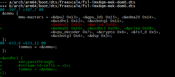

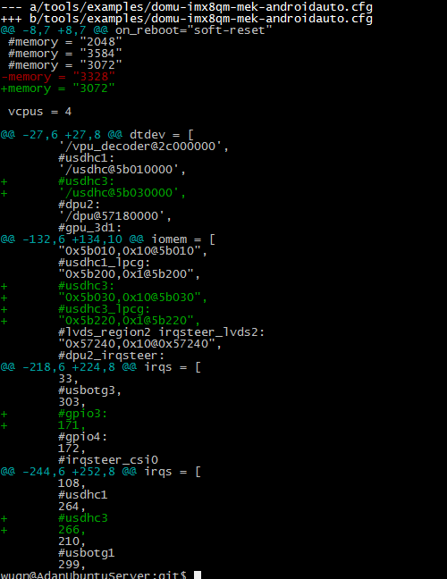

I want to use usdhc3 for wifi sdio,i try to change dom0 dts to passthrough  usdhc3 for domU(android),as follow :
arch/arm64/boot/dts/freescale/fsl-imx8qm-mek-domu.dts:
and the log is :
libxl: error: libxl_create.c:1345:domcreate_launch_dm: Domain 3:failed give domain access to iomem range 5b220-5b220: Operation not permitted
can you help me please!

Please add a node including sdhc3 lpcg iomem, and mark passthrough, no need smmu entry for it. Check how lpuart passthrough in imx8qm-mek-dom0.dts.
