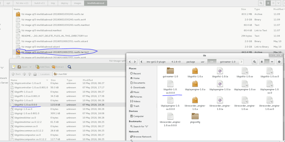

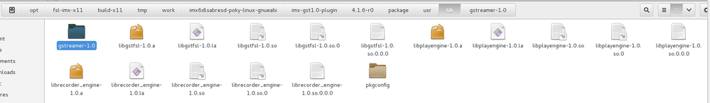

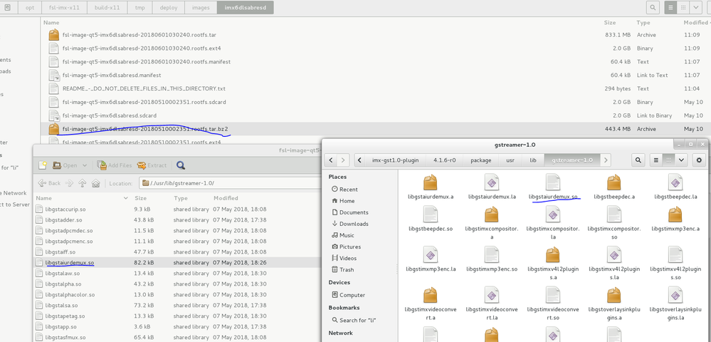

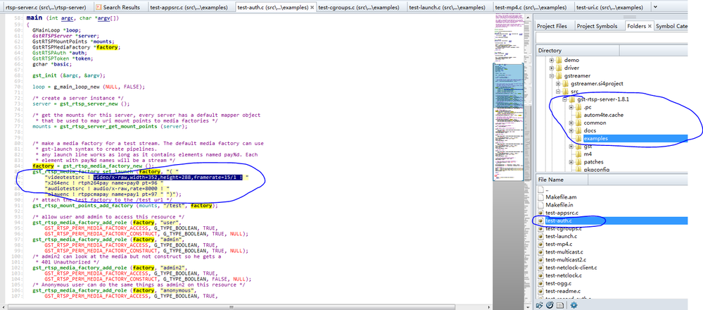

riguangpeng
Hi, igor:
I look up the rootfs which is building from yocto, it package the gst1.0-plugins-fsl, the version is 4.1.6.
now my problem is that when I integrate with show, save to rtsp launch as the following picture, then play the pipeline,
it doesn't save the file in my disk flash or show the video on screen. If I connect the rtsp server from rtsp client of VLC in my PC, it will trigger the launch of rtsp server to run.
Can you give me some advice  how to save, show the streaming before I connect rstp server from the client?
the following picture is for gst-plugin-fsl:
4,542 Views
