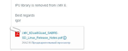

igorpadykov
Hi veeranjaneyulu
seems it is not supported on i.MX6, please refer to
attached Release Notes p.10 :
IPU library is removed from i.MX 6.
igor

please can you attach Release Notes P.10 once .but in the above you mentioned that release note but not attached .so can you attach that release Note .
