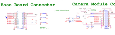

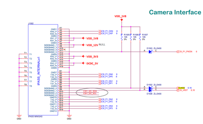

     The OV5640 MINISASTOCSI board  proivded a 24MHz source.
     i manually replaceed the minisastocsi imx219 sensor with the original ov5640 sensor.( schematic is same).

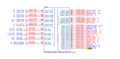

    however, after i compiled the dts ,the log shows an error about the imx219 clk frequency rate is not 24MHz. no matter how i changed the clock-parents, the kernel couldn't get the 24MHz for the imx8mqevk board use 25Mhz and 27MHz as the osc source. no value in clk-imx8mq.c could be evenly divided by 24.

clocks = <&clk IMX8MQ_CLK_CLKO2>;
clock-names = "csi_mclk";
assigned-clocks = <&clk IMX8MQ_CLK_CLKO2>;
assigned-clock-parents = <&clk IMX8MQ_SYS2_PLL_200M>;
assigned-clock-rates = <24000000>;

i referred several topics similar but it likes to put GPIO1_IO_15  to generate  24MHz clk output not an input.
https://community.nxp.com/t5/i-MX-Processors/enable-CLKO2-for-24MHz-output-clock-on-iMX8MN/m-p/12776...
