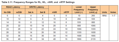

I'm using IMx8MP excel RPA for changing the conditions. The default values in the RPA are WRITE_LATENCY 8 and READ_LATENCY 14 at 800MHz. I modified it as WRITE_LATENCY 10 and READ_LATENCY 20 in DDRC_DRAMTMG2 register. The latencies in MR2 are connected to the register in the excel sheet. However, the generated .ds file had calibration failure on DDR tool as attached. How can I solve this?

Hi @jekim
We strongly recommend that customers do not modify the WL RL, This two parameters will changed follow DDR frequency change.

the latencies per frequency are as below.

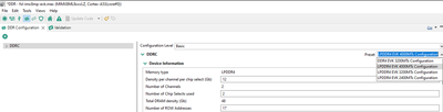

You can change the default data rate from Clock Cycle Freq option
The Preset are the default configuration for NXP EVK boards, from where the configuration can be customized.

jekim
Hello @addiyi ,
The latest DDR tool show 3 presets for IMX93. "EVK 11x11" has only LPDDR4X not also LPDDR4. Does only "QSB 9x9" support LPDDR4 configuration?
Thanks.
2,387 Views
pengyong_zhang
This just means it is a 9x9 QSB configuration, you just need to configure your LPDDR4X parameters normally
2,376 Views
jekim
Hello @pengyong_zhang ,
There are two different devices. They are LPDDR4 and LPDDR4X. The 11x11 preset shows only LPDDR4X. How to choose LPDDR4 config for 11x11?
2,357 Views
pengyong_zhang
Hi @jekim
As i mentioned before, this choose is just use choose which SOC, you are not need to care about LPDD4 or LPDDR4X, Just configuration your DDR parameters is OK.
