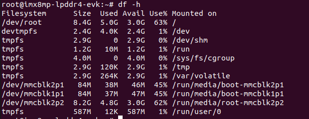

i am using imx8mplus custom board . i build the IMXLXYOCTOUG v.LF6.6.3_1.0.0 BSP .
i build the imx-image-full.
i used the 32 gb SD card
i flashed the wic.zst image into sd card by using the below command
zstdcat imx-image-full-imx8mp-lpddr4-evk.rootfs.wic.zst | sudo dd of=/dev/sdb bs=1M conv=fsync

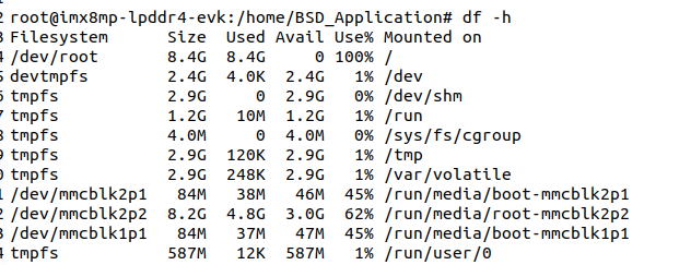

i ran the my python program which continously stores the images in root(/) directory .
after running my application for 30 mins , it is getting OSError: [Errno 28] No space left on device
memory space after ruuning my program
how to increase the size of root directory . where i have to modify .please help me out .

One way I tried as followings.
sudo parted /dev/sdb unit MiB resizepart 2 20001  /*You can decide the size accordingly, here mine is 20001*/
sudo dd if=imx-boot-imx8mnevk-sd.bin-flash_evk of=/dev/sdb bs=1k seek=32 conv=fsync
Then you can follow up the guide <4.3.5 Copying the kernel image and DTB file> of IMX_LINUX_USERS_GUIDE.pdf  to copy kernel, dtb to sdb1 with vfat partition
then follow up the <4.3.6 Copying the root file system (rootfs)> to copy rootfs to sdb2 with ext4 partition
