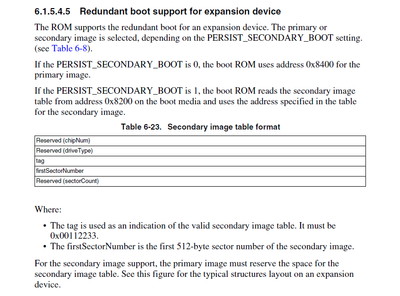

I am trying to use redundent boot feature supported by imx8m mini as described in reference manual and
Can you please explain or point me to a document how to update the area "Reserved for Secondary
Image Table (optional)" at 0x00008200, so that if primary bootloader corrupted secondary bootloader is picked.
 I am using imx8 yocto - sumo release.
I have also tried below steps: given in document AN12900
Primary U-Boot:
sudo dd if=signed_flash.bin of=/dev/<sdX> bs=1K seek=33 && sync
Secondary U-Boot:
sudo dd if=signed_flash.bin of=/dev/<sdX> bs=1K seek=2048 && sync

Hi Girish
one can try guidelines provided on
https://community.nxp.com/t5/i-MX-Processors-Knowledge-Base/i-MX-8MQ-ROM-Redundant-Boot-for-expansio...
